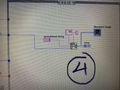

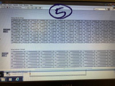

Hi, I actually I post brief about the question. Unfortunately I found it’s not posted.
I want to get output 2D array from this string indicator output data (as in image 1 & 2). Image 2 block diagram I have used to connect block diagram of image 1 & 2. As you can see (image 5) I have get some output in string indicator (freq) and string indicator 2(Ampl). Now want to convert these output from string to 2 D array. So I have tried this block diagram(in image 4) but I did not got any output data you can see in image 6.
Mainly I want to know how can I receive output data of those two string indicator and convert those data in 2 D array. So that finally can plot Amplitude vs frequency (x vs y) graph using those two data obtained in string output.

Your string indicator seems to be a comma delimited table of floating point values, but we cannot tell if there are any linefeeds, so it is either a 1D (no linefeeds) or 2D DBL array.
Simply wire it to "spreadsheet string to array", set the delimiter to comma, the format to %f, and the type to either a 1D or 2D DBL array.
If you need more help, run your VI until that string indicator has data as shown in your picture. Then stop the VI and right-click the string terminal and "create constant". Copy that constant to a new VI and attach it here.

Actually I have used “stacked sequence structure” which have total 16 case structure. In between each case structure I have added wait time of 30 sec. I have attached the drive link for stacked sequence herewith.
“Repetition of the question”
I want to get output 2D array from this string indicator output data. As you can see (in front panel) I have get some output in string indicator (freq) and string indicator (Amp). Now want to convert these output from string to 2 D array. So I have tried this block diagram (16 on sequence) but I did not got any output data you can see in array and graph of “front panel”.
Mainly I want to know how can I receive output data of those two string indicator and convert those data in 2 D array. I am unable to receive that two string output data to get data in 2D array. So that finally I can plot Amplitude vs frequency (x vs y) graph as well as extract numerical data in .csv.
