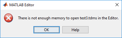

My acquisition system save data on TDMS file (.TDMS) and there is a lot of them (more than 1048575 rows of data)
I try with Matlab and Excel (as it is explained here https://www.ni.com/en-gb/support/documentation/supplemental/06/the-ni-tdms-file-format.html) but these editors can't handle the size of the files.
Then, how can I verify the value of the files to have a quick overview ? in table ? by splitting the TDMS file ?

That limitation is an Excel problem. I guess Matlab can handle larger datafiles, but here the importer seems limited.
Options:
  • NI provides Diadem to handle huge datafiles.
  • You can also try the TDMSFileViewer, which is found in the TDMS functions palette…
