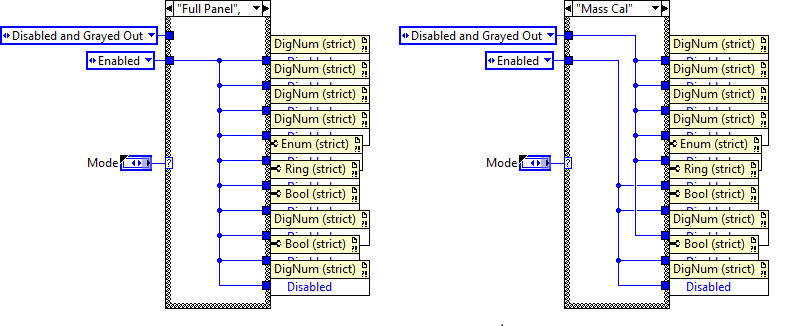

Or, if you have set conditions for which different combinations of things are made in/visible, you could use an enum for your conditions and choose the individual actions for each in a case statement. In the example below, I was switching between "Enabled" and "Disabled and Grayed Out" states to let the user know which controls s/he could adjust in the area of the program s/he was currently. I apologize in advance for using a picture, but the VI I'm taking it from (the instrument configuration panel) would be a real pain to disassemble enough to give code (there are 40 or so controls that I'm manipulating). The other "Modes" have different combinations of enabled/disabled conrols.
It can get big, but you're just talking about a single column. If there are significant groups of objects which always are switched together (I wasn't that lucky), then you can also bundle them to make the column shorter, as Phil_ said.
