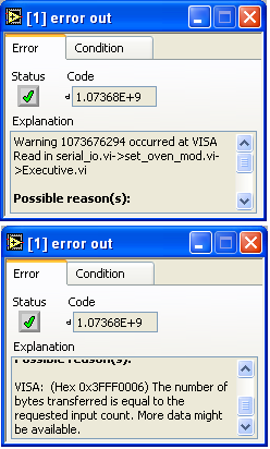

with "64" as my flush buffer value. i get this warning sign.
Krispiekream

Is there a particular reason you are flushing the buffer?
With all the serial stuff I've worked with, I've never needed to do a buffer flush.
PS:  Something is odd about your error probe for it to show the error number in scientific notation.
