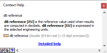

Hi everyone.  Thank you for your replies.  I realize the subject of my post is a bit misleading. I actually know how to convert mm/s^2 to mm/s.  Below are my questions, and I was able to answer one of them myself.  Can anyone help with the first one in BOLD? I also uploaded a snippet so you can see my code easier:
  • Q1 What do I specify for dB reference and pregain?  Or can I ignore these?
  • Q2 I am grabbing 2048 samples from the buffer (chunk size=2048) every iteration because I want to display the data quickly.  The VI that is calculating RMS appears to be giving me an RMS value for every chunk, instead of every second.  How do I get a value every second?
    I was having trouble using the RMS subVI from the  Sound & Vibration toolkit, so I just switched to the one shown below.  It calculates RMS once per second nicely now.

Hi josborne,
I haven't used the Sound & Vibration toolkit but if you're converting a voltage signal to engineering units, the pregain value is usually used to account for any gain applied to the signal before it reaches the data acquisition system.  For example, if you were passing the voltage signal through an amplifier before connecting it to the DAQ the pregain would specify whatever gain had been set on the amplifier.  If you have no pre-conditioning, set the gain to 0 if it's specified in dB or 1 if it's a linear scaling.
The dB reference is just whatever reference value is used when converting from engineering units to decibels: dB value = 10 * log10(signal^2 / dB reference^2).  Changing the reference by a factor of 10 results in the dB value changing by 20 dB, i.e. 10  * log10(10^2), but as long as you're consistent it doesn't matter so much as it can be easily corrected.

@PsyenceFact wrote:
Hi josborne,
PsyenceFact
Exactly right and affirmed by SVT help for those controls:
Doug
