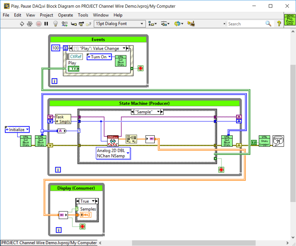

Here's another, simpler State Machine Demo using Channel Wires:
I called this a "Channel State Machine", as the Channel Wire in the Feedback Path (here Blue, the color of the State Enum) only carried "Next State" information. But note there are other Channel Wires here, including a Stream Channel (orange) implementing a Producer/Consumer design, with the Stream's build-in Sentinel feature (yay!), and a Tag Channel (green) used only to shut down the Event Loop when the Producer executes its final Exit state.
I encourage you to explore Channel Wires (as David Foster Wallace would say, I.F.I., which means "If You're Interested") and, drawing on the LabVIEW skills you already have and the examples/tutorial that ships with LabVIEW on Channel Wires, to create your own version of a State Machine and/or create a QMH from the QMH Template and replace the Queue routines with equivalent Messenger Channel routines to get the first "picture" I showed. Your efforts will be rewarded ...
