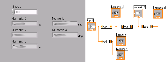

In this case, the third paragraph if the section "Convert Unit Details" applies:
Quote: "If the input is a pure number, LabVIEW assigns the unit you specify in the Convert Unit function to the number and returns that physical number in the base unit (or a combination of base units) for that class of measurement, as indicated in the following table."
The "base unit" of an angle is rad. Yes, it's a bit confusing but at least documented. 😄
For some fun, look at the attached VI diagram and front panel. Don't run it yet!!!!
Can you tell what all the indicators will show without running it?
Now run it! Were you right? 😄
