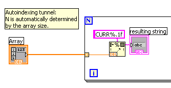

I want to use  a single element seqentially starting from Index zero in an array(1D) and use that element. How can I choose one element each time from that array and use it.?

Assuming you use a FOR loop, it is sufficient to autoindex into the loop and you'll get one element per iteration (starting with element zero) until you run out of elements, at which time the FOR loop ends.
For more complicated needs, just use "index array" and wire the index to simething that increments at the desired rate (e.g. the [i] terminal of a loop).

Thanks altenbach,
Does that mean that i just connect the autoindexed point on the for loop where I can output the elements to my further string in which each element will be automatically formatted into the string.
If the first element outof the forloop is say 1.0, i connect it to a format string input CURR%f, its first output will be CURR1.0 and so on as the for loop iterates. have I interpreted it right?

Yes, like everything is LabVIEW, it's that simple!
You don't need to wire N, etc.
