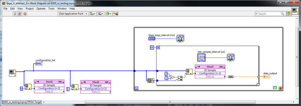

I decided that perhaps I could create a poor man's pull-down by sampling a grounded input channel before sampling a channel with a real signal on it.  I found this article from NI that discusses using an FPGA IO Sample method for low-level control of the registers (or whatever) that control the configuration of voltage range, terminal configuration, and channel order that is used by the 9205 at runtime.  Getting very excited, I put together an FPGA VI that is intended to sample channel 31, which is connected to ground, between every other channel on the module, thus draining the sampling capacitor and giving me a clear indication that a particular channel has become disconnected.  So the sampling should go AI0, AI31, AI1, AI31, AI2, AI31, etc.  We don't need to sample at any higher than 50 Hz so I don't care that I'm cutting the effective sample rate in half, but our application does require us to know if a channel has become open because of a broken wire or something.
The bad news is that despite creating an array of configuration values that samples channels in the order described above, it appears that the 9205 is still sampling in numerical channel order.  My test setup is as follows:
AI0   - 5 volts
AI1   - open
AI31 - ground
If I sampled in numerical order I would expect to see 5 volts on channel 0 and something close to that on channel 1, which is what I actually observe.  When I sample in the order AI0, AI31, AI1, I expect to see 5 volts, 0 volts, and 0 volts, but that's not what I observe.  Instead I see 5 volts, 0 volts, 2.4 volts.  I've messed with extending the time between calls to the IO Sample method, thinking that it might leave the mux connected to ground longer and thus drain the cap further (I'm not sure if this is a valid assumption), but this doesn't change the value measured for channel 1 at all.
Here's a screenshot of the FPGA code:
Here's the real-time code:
Here's the results on the front panel:
Questions:
Looking at the results, it's clearly returning the data from channel 31 in between channels 0 and 1, but channel 1 does not look like the cap has been drained.  Am I really controlling the order in which the channels are mux'ed to the ADC, or am I just controlling the order in which the data is returned to me?  In other words, does the mux always go from channel 0 to 31 in order, no matter what I request?  If so, why does the article linked above explicitly tell me that I can control numerical order?

I believe you are correct in that the MUX always go from channel 0 to 31 in order. I am curious to know how much ghosting is happening in your actual application, and what the details of your physical set up. If you are seeing unexpected measurements your signals I would recommend double checking that you have the proper grounding in your system. Please see the Field Wiring Guide for more detailed information regarding grounding.
Something worth mentioning is that we do not recommend reading open channels as that is not the intended use of the device therefore resulting in possible unexpected readings.
