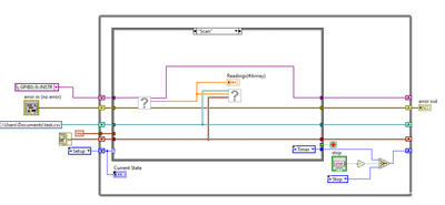

Thank you for connecting me to this other forum post. I have attempted to write my own program to closer match your example. But I have encountered a few errors when running the program. I also tried to make a state machine structure for the first time so sorry if there are errors I missed:
1. "Error 1: In Scan state: Error 1 on Find in String (arg 1) in Scan-now.vi, Possible causes: LabVIEW invalid input parameter. This path cannot contain characters like ? or @ that are not allowed in the respective operating system. The 'Scan from String' function in the Scan-now.vi is highlighted upon appearance of this error." I do not understand what is wrong with the input parameter as the Array # output is showing numerical values.
2. Error 2: "Error 7 when opening/creating/replacing a date in Write to xls file wit timestamp.vi. Possible causes: File not found. The file may be in a different location or may have been deleted. Verify the file path is correct." I have checked that the input file path is correct.
3. Finally, the numbers that appear in the array reading are not realistic. There are negative decimals whereas the I know the values should be ~20. I used the right configuration parameters for the thermocouples, so I do not understand why the numbers are wrong.
Message 3 of 8
(2,296 Views)
  1. Mhmmm... that does not make sense to me but maybe it's related to 2
  2. That is because you did not wire your shift registers and after the very first iteration. The "Use Default if Unwired" sets your file path to the default "Empty path". You click on all your tunnels on the Case and check "Wire all unwired cases".smecCapture.PNG
  3. Thermal couples will read backwards if they are hooked up backwards. T type TC the Blue is positive and should connect to the high (H) side of the 34901 MUX module input. Also wildly varying thermocouple measurements is a sign of an open or intermittent thermocouple.

Fixing the shift register solved #1,2. Thank you!
With regards to #3, I am confused because when using the EZ_Temperature.vi (which I now know is bad in terms of configuring the channels every time it is called!) that comes with the instrument driver, I was getting the right temperature values. The settings for this vi were T-type Thermocouple. The wiring was the same on the Agilent. I feel like there is something I am missing on the configuration. When using the monitoring button, the channels are now reading the very small negative decimals. Any thoughts?
With regards to #4, when you say a 'Timer' state, would this state follow the Scan state with a delay and then go back into the Scan state upon completion of the delay time? What type of function would go in this Timer state? A tick count where the value is compared with the scan rate which if true goes back into the scan state? Sorry, still trying to understand machine states and hoping this is on the right track!
