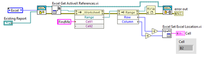

Hello all,
I hope you can help me. I want to find the correct cell location e.g. B2 if I use the cell name as a input e.g. "FindMe"
I think this must be easy I cant find the correct way to do this however. I am using the Report Generation Toolkit.
thanx for the help!

This is possible, but requires using Excel Get ActiveX References.vi:

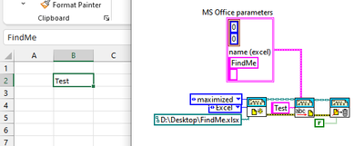

If you want to write text to that location, use the "MS Office Parameters" cluster and the "name" string control.

Hey Darren, thank you!
I cant select the "Range" option in the property node, I can only select "UsedRange" . Do you have got any idea what could be wrong ? I did also search for Cell1 it is also not there I can find "Cells
(1,366 Views)
Hello Darren, I did not look good enough at your example. I did use a property node but the first one needs to be an invoke node.
Now it works! thanx!
