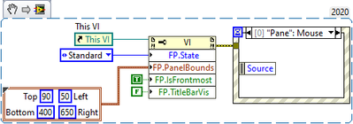

As far as I know, LabVIEW can't interact directly with the video card. It can, however, send an image to each monitor, which would be enumerated by Windows. You can create a window, then set which panel it displays on and set it to Maximized.
In other words, you would need Windows to recognize the ports and monitors before LabVIEW could do anything with them. If there are some lower level API's available then someone else might be able to help. It would be good if you could explain what you're actually trying to do.
(1,564 Views)
/google "LabVIEW Boarderless front panel"
See if this gives you any ideas...
(1,558 Views)
