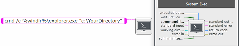

I know this is old, but I was looking to do this in NXG, and this works fine for me.

Hi, what is the name of that function in the middle? The yellow one in your example code?

Can you tell me, what is the yellow function being used in this code? I'm stumped!

This is a long thread.  Which message are you referring to?
Back in Message 11?   That would be Format Into String.

Yeah can confirm this. I prefer the sys exec approach as when it is a directory I would prefer to browse into that directory.
