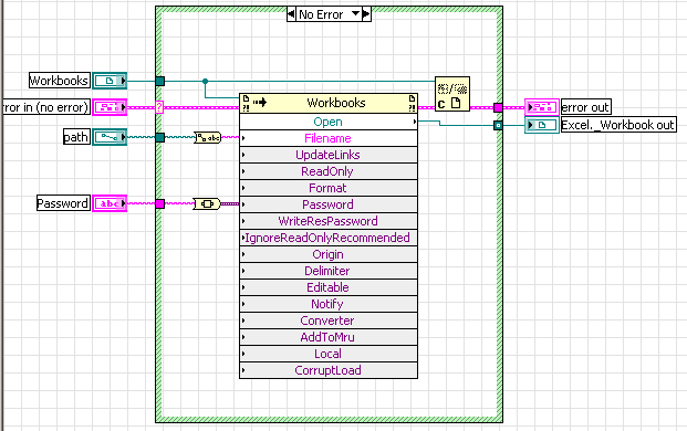

Try it this way

Hi! Muks,
Thank you so much for the reply. What type of refnum are using. Is it an application refnum? Supposing that I opened the file using report generation (so that I will just append the data), how can I transform a 'report out' into a 'refnum'?

You can use the Workbook reference.

Hi Muks,
Another question, sorry for this one. I am very new to LabVIEW. How can I generate workbook refnum? Is there a necessary thing to do beforehand. I tried application refnum and no workbook among the choices.

Hi Muks,
Thanks a lot for all the help.
I already figured out how. I just explored. I find this 'Get Excel ActiveX Reference.vi' and on its property node there was a unprotect option. Anyways, thanks a lot for answering.
