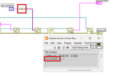

I'm logging a timestamp, a string and a variant to a binary file. Very simple and works fine except that somehow the string "value" gets written to the binary file.
Do the following steps:
1.
2.
3.
So the string "Value" is written into the file, but it does not match the label of the control. (This control is copied from my application to this standalone VI!). I'm positive that in my original application the string "value" comes from the call chain as if change the input name of a variant input 2-3 levels up in the hierarchy then the string "value" in the binary changes  to the name of that input. For me it seems that the "value" string somehow sticks to the variant data at the first time the data is converted to a variant, but I couldnt reproduce the issue outside of my app. (also I'm working with malleable VIs, if that matters)
Having that label value doesnt make any sense to me especially if it comes from several layers up in the call chain. Is this a feature? Is this a bug? Can I somehow change this text in my logger VI or can I completely remove it?

This is an expected behavior, because the data name is part of the data type, which is part of the value of a variant.
If you right-click on your variant control and "Show Type", you will see the data name as well.
You can use VI "Set Type Information" from "LabVIEW 20xx\vi.lib\Utility\Data Type" to remove the data name and type definition infos from your variant value:
Note: "Set Type Information" only applies to the top-level value, not recursively to sub-elements (such as cluster elements, array elements, map/set elements...).

I think your are confusing the wire name and the data name inside the variant.
A wire has a label and a data type that are fixed at compile-time.
A variant is a data type which value contains 2 things at run-time: an "inner" data type and the value associated to this inner data type.
When you wire e.g. an I32 to a variant input (either directly, making a coercion dot, or via a "To Variant" node), the label of the wire of your I32 becomes the data name of the "inner" data type. So in some sense, the edit-time name becomes run-time. So ultimately, even if your variant control may have some name ("Test data" in your 3rd example), the function "Write Binary File" only flattens the value of the variant, namely the inner data type and the value associated to the inner data type. So this is why you see a different name in the binary data.
The function "Set Type Information" allows to change or remove the data name inside the variant value.
Your code just deletes the variant completely, including its content (data + type), so I don't see what you can do with this...
Raphaël.
