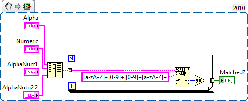

How can I verify if a string contains numbers AND letters using a regular expression only?
I can do that with using 3 different expressions ([0-9],[a-z],[A-Z]) but is there a unique regular expression to do that?

It looks like the previous answers will match a string that contains alpha or num, not alpha and num only.
Jim

Missed the requirements:
single regex:
^([[:alpha:]]+[[:digit:]]+|[[:digit:]]+[[:alpha:]])[[:alnum:]]*$
You either have 1 or more digits followed by 1 or more letters or 1 or more letters followed by 1 or more digits. Once that is out of the way, the rest of the string must be all alphanumerics.  The ^ and $ make sure the whole string is included in the match.
(I have not tested this at all, just typed it up hopefully I got all the brackets in the right place).

If you are keeping score:
1.  Bracket balancing is only a problem on my phone, in LV it is a easy to debug error.
2.  Using my regex helper means I do not even have to worry about it or remembering the exact syntax of any of the posix classes.
3.  I know precisely what happens with unicode fonts and languages with letters outside of A-Z (and I think I know precisely what does not happen with the lexical class function)
4.  Calculate how much time it takes to modify each version when you decide that radix points (. or ,) should be allowed, and then decide that negative numbers should be allowed.
