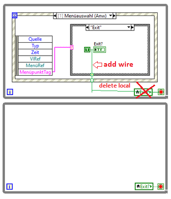

You have a glaring race condition, because when the event sets the "true", the local has already been read as false.
(There are two independent code fragments in the upper loop and both execute in parallel at new every iteration:(1) local is read and passed to the termination condition. (2) event structure waits for your menu action. It is important to understand dataflow here!)
Your local in the upper loop would get read as true on the next iteration, but that is waiting for another event and the loop cannot complete until the event structure has completed again.
Just wire from inside the event to the termination condition, no local needed there! All tunnels should be set to use default if unwired.

Because of dataflow, which is the basic paradigm LV uses for executing code. A block of code (in this case, reading a value from a local variable) will execute at some undefined point in time after its containing diagram starts executing and after it got all of its inputs (which in the case of a local variable is none). The wire is coming out of the event structure, so by definition it will only have a value after the structure is finished executing.
The fact that the local variable is connected to a loop stop condition is not relevant, as code following a node does not dictate when it executes, only code coming before it. LV might decide in some cases to do some optimizations to execution order based on downstream code, but that's not something you should rely on.
In short, your C experience is not applicable to this case, as LV follows dataflow, where things can run in parallel, so you need different considerations for how to execute things in the order you want.
If you really wanted to read the value from a local variable after the loop was finished, you would need to create some kind of dependency to control this (for instance, placing them in a sequence structure). I expect that any of these changes would make the code less elegant than simply using a wire (which is generally the most direct equivalent to a local variable in C, so if you're willing to accept the equivalence, that's where your C experience is relevant).

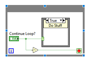

In C, you can exit your loops at any time using return, goto, continue and break (which all have their uses) and you can decide if you want to check before (while) or after the first iteration (do ... while). Maybe you are used to a certain coding style guide in C?
LabVIEW supplies a do ... while loop. The difference to C is that you have no guarantee on the order of operations. That, however, is kind of the point of having a language that uses data dependency instead of sequential execution.
If you absolutely must have your condition checked before the loop body, you can easily do that:
It is easier to work with the tools then against them, even if we find that they don't click with our style. I remember the old joke "Real Programmers can write FORTRAN in every language".
