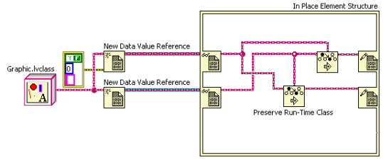

Then there's this:
With a new Preserve Run-Time Class.vi primitive, LabVIEW can guarantee runtime type consistency that you can use to swap two values. If you need a class reference that lets you change the underlying object, create a reference to a cluster of the class. This gives you the ability to swap values at the cost of hierarchical casting.
I don't know what that's supposed to tell me. As I have learned, the NEW DVR makes two NEW instances of the GRAPHIC class, each containing the same data.
Then you dereference them both to get a GRAPHIC, but you can't swap them without the PRTC because.... I don't know what.
I don't think the pic refers to the statement right before it:  If you need a class reference that lets you change the underlying object, create a reference to a cluster of the class.
The pic is not doing that.
