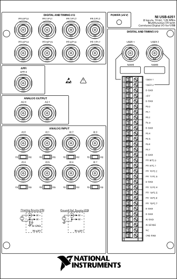

Just made a virtual USB-6251. When I query the physical channels I get all 16 of them, even though there are only 8 BNC inputs on the USB-6251.
Even though the ai8 channel is not on the BNC device, you can still get information from it. See this post. So if you set up your channels correctly, it shouldn't matter.
I agree that it is confusing to list 16 channels when a device only has 8 BNC inputs on it, with no additional screw terminals that give access to the other channels. Maybe there is a way to query this programmatically?
Below is a picture for those who are unfamiliar with the device.
