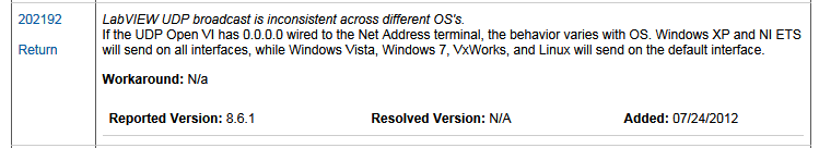

Worse this problem as been around for quite awhile: (note the workaround is "N/A")...
LabVIEW 2014 Known Issues from NI.com
Regards, Thanks for at least some reply!. 😉

In the known issue you referenced (CAR 202192), it explains that the UDP behavior IS consistent between Win 7, Vista, VxWorks, AND Linux. Only XP and ETS (Pharlap) broadcast UDP on all NIC interfaces while all the other OS's broadcast on the default NIC. In addition, this CAR references 'broadcast' and I thought your original issue was with 'multicast'? This CAR doesn't prove that Linux is doing something differently than VxWorks (it states the opposite), and I'm concerned that you are not even using a Linux based controller.  I want to make sure we are on the same page solving the same problem, and not assume that Linux is the variable and therefore the problem.

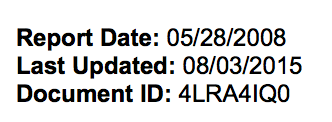

Hi Jack,
Sorry if I implied that it should be obvious that a specific target is running Linux vs. VxWorks.  Also, the KB that Rolf referenced does indicate that it was updated as recently as August 2015.  I'm asking the ELP engineer/AE who should be monitoring this thread to update the KB to remove the reference to LabVIEW 2009 SP1 as Primary Software Version to avoid the confusing impression that this information is out of date.
