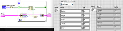

Hello Community,
When communicating with a device, I receive U32 packets and want to convert them to a defined structure. I create a typedef cluster that has in total 32 bits. The idea is to typecast the U32 to this cluster. The issue I observe is that the typecast function does not preserve the bit pattern when there are booleans in the cluster. From what I see, the booleans are not represented by a single bit.
In C++, I used to do this with a union, which allowed me to reinterpret the bits directly.
The goal is if the structure changes, I just need to update the typedef in one place, so my whole code is updated accordingly.
I strongly think I have used this technique with previous versions of LabVIEW (LV2021).
Could you confirm if this is a known issue, and do you have any alternatives?
Please see attached vi as exemple.

A LabVIEW boolean is really an 8-bit value. Yes it seems overly wasteful but 8-bits is the minimum amount addressable by pretty much any CPU architecture still being of any importance out there. So if you  typecast a 32-bit integer into a cluster with booleans it will simply fill in the first 4 booleans, interpreting each byte as one boolean and making the boolean true if that byte is anything but 0. And this has been like this since LabVIEW 5.0. Before that a LabVIEW boolean was a 16 bit integer (an inheritance from the Macintosh Classic OS) and a LabVIEW Boolean array was indeed a packed bit array. But especially that packed bit array turned out to be a serious performance problem as the conversion between a boolean array and other types was computationally rather expensive, so the boolean was revised for 5.0 to be a byte (as most other compilers do by default too, if they support a separate boolean datatype) and the array of booleans was simplified by simply being an array of bytes too.
If you need to deal with bitflags you could use Numeric to Boolean Array and then index into that array or build a boolean array and convert it with Boolean Array to Numeric. BUT: Especially the Numeric to Boolean Array function is performance wise quite a hit as it needs to create an array of bytes for something that you usually throw away anyways right away after having looked at one or two of the booleans. I always use boolean logic instead. The LabVIEW AND, OR and XOR nodes happily work on integers too. You just have to do a little more work in determining the actual value to look at a specific bit in an integer but the resulting code created by LabVIEW is as close to the silicon as you can get in a high level language. It is helpful to use Hex notation for the numeric constants used to do these boolean operations, but if you are not as used to it and want to see things on bitlevel you can also choose binary representation for the numeric constant. Also you want to treat these usually as unsigned integer to avoid trouble with two's complement logic.

Thank you for your reply.
You are correct, what I meant was a bitfield in C, not a union.
My main goal is to simplify the code rather than optimize for performance. Since the product is still in development and the bit structure of the U32 data may change, I’d like to avoid building an entire factory just to manipulate a few bits.
I’m surprised there isn’t a more intuitive way to do this in LabVIEW.
Should I make this in C and then call it from LabVIEW, would that work ?

Thanks also for you reply. I don't see how intuitive it is with the conversion of the full number to a boolean array. Please consider my goal is not to convert the array to boolean(bits) but to manipulate a defined structure as shown in the attached vi in my post.
let me wirte an example
let's assume I recieve U32 from device defined as follow:
{Speed: 16       //16 bits
Angle:  10        // 10 bits
State:  4           //4bits
Device_on: 1   //1 bit
Error: 1            //1 bit
then tomorrow it changes too:
{Speed: 10       //10 bits
State:  4           //4bits
Power: 1          // 1 bit
Error: 1            //1 bit
code: 3            // 3bits}
My idea was to do like in C, create a cluster typedef and then update it accordingly, without modifying the code or just a minimum

Well, bitfields are definitely not as portable as you might believe. They are a perfect way to make your C code into a troubled bit of mess if you are not careful. Basically, Endianess throws all your assumptions away if you are not super careful and there are other potential problems with bitfields. Yes you may say, Endianess? who cares anything is Little Eindian nowadays. Until you come into network communication and other stuff, where the network byte order still predominantly is the standard and that is Big Endian. And of course LabVIEW itself with its Typecast function which always assumes Big Endian too, for traditional reasons as the Mac originally run on a Motorola 68020 CPU which was Big Endian too.
However if you want to contain your modifications to one or two places it is quite feasible to define a LabVIEW cluster that can accommodate your data, make it a Typedef and write ONE VI that converts the bits from the device into this cluster. Mission accomplished.
