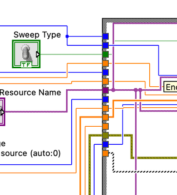

When I open "EG-FET IV_2.vi", I get a bad wire:

Well, that's the version they hacked around.
Still waiting for the original 2019 dependencies, especially "EG-FET IV.vi" and  "Keithely 230_reworked-2.vi", both called from the 2019 toplevel "EG-FET IV - FET.vi " attached earlier.
I guess once we have both "EG-FET IV_2.vi" and "EG-FET IV.vi", we can compare and se what went wrong. 😄
