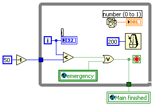

my suggestion is to place the main prog outside the loop B but inside loop A. This makes sure, that Loop A is turning once with every execution of the main prog. Beside this Loop B is executing independently. Then you need some communication between your main program and the loop B which can be implemented easiest with global variables, one for each communication direction. This could look like this to abort the main prog on "emergency":
and to tell the Loop B to stop on finish of the Main prog:
In the main prog- VI (which is a bit weird, because the while loop execute always and only once and therefore is unnecessary) your experiment shoult execute in a while loop, since it is abortable dynamically. The for loop will execute the predefined count, defined by wiring the "loop count"- terminal or wiring an array with autoindexing.

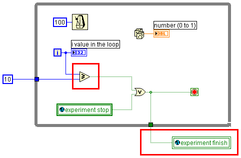

I altered your VIs and hope, this is what you need.
and "experiment.vi":
What I don't understand is the function of the switch "Start/Stop monitoring". Can you explain its function? And shall Case Structure C only run one time after pressing this switch? Or shall it run every third loop-count?
