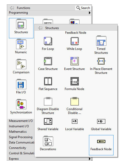

where can i find these?
Message 8 of 12
(5,084 Views)
Message 9 of 12
(5,078 Views)
Hi Dany,
the other is a FALSE boolean constant from LabVIEW before LV2011 (or LV2010)…
Message 10 of 12
(5,063 Views)
