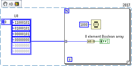

Hello everyone I am new to labview. I am trying to set up a vi in which I have a row of 8 LEDs and a push button. I want to be able to push the button and have it start and stop specific LEDs for a desired amount of time. specifically I want to start LEDs 1,3,7 and 8 and keep them on for 3 minutes, turn off 8 and then 7 in that order and then keep the remaining on for 2 minutes. Then turn the rest off and move to the next sequence. I have tried separating the LEDs into groups of 3 for the sequences but then I was left with 3 while loops and was not sure how to control the timing.
The reason I am setting this up is to run solenoid valves that clean 3 different lines with each sequence of LEDs representing a different line. So I wanted to essentially set up an autonomous cleaning cycle.

You could start with something simple like this. Use each bit in the U8 integer controls one LED. Pre-load the array of U8s to define the solenoid sequence.
 I didn't feel like waiting 5 minutes for the complete cycle, so I just have them changing once per second.

Hi
thank you for the response I wanted to ask how would you indicate which Boolean LED is the integer input in the U8. like how do I make the first Boolean led the first input into the array.

@Athakore wrote:
Hi
The first LED would be Bit 0 in the U8 and would correspond to the Solenoid Valve[0], the second LED would be bit 1 and Solenoid Valve[1], etc.
Many commercial switch matrices use this method (was assuming you would be trying to control real hardware and not just the front panel UI). If you use clusters then it would look something like this (I used msec instead of minutes for the dwell)
