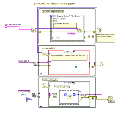

HI Smcal234
Thank you for sharing your code.
The error you are receiving is because the device didn't responded to the command you sent.
In your code, you are consantly Serial Config, writing/reading and then closing the port.
The opening could be executed only 1 time in the beginning of the program... and closing at the end.
You could make use of Sub-vi -  is a vi that you use to reuse the code, instead of repeat the code over and over everytime it's needed.
The commands you send / receave from serial could be implemented on the Subvi and associated to the command you are trying to execute.
Finally, a program strucuter of producer/consumer (EVENTS) would make your code easier to mantain.
This structure has 2 loops:
The Producer loop (top) - that constantly monitors the User interface for any change and in case of any interaction of buttons, numbers change, it will trigger a commnad to the Consumer loop.
The consumer loop (bottom) would basically receive the commands fromt the producer loop   and send the command to serial.
In your case, you could have 2 consumer loops one for each serial port MW_Supply and another for MKS-600.
A draft version of the architecture is the diagram bellow.

Quick question about this templete. Should I have two event cases for each intrsument in the producer loop if I want to keep the commands from the MW_Supply & MKS_600 seperate? I have tweak the string values differently.

That depends on what you are trying to do. Do note that each instrument consumer should have its own queue. So a single event case could send a command to each of the instrument loops.

You need to create 2 queues, one for each serial port.
Then on the producer loop, you associate the proper queue message to the right queue direcgted to the proper consumer queue.
On the consume loop, you need to create one case for each "queue" message, meaning each user interface interaction will trigger a different message/command to the consumer loop.
