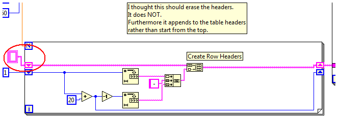

Hi NI community,
I need your help with deleting the row headers of a table.
The first time the program runs everything is OK.
However, when the user sets a new number of tests and clicks the ‘Run Again’ button the old row headers not only are not being deleted but the new ones are appended under them.
I would like the entire table, headers including, to be deleted and the new results to be displayed starting from the top of the table.
I am attaching a sample program.
Thank you in advance for your help.

Here are some ideas (let me preface this by saying I've not worked much with Tables).
1.  The Set Cell Value method you are using has been removed in LabVIEW 2012 (and successors), so you may want to consider an alternative.
2.  Writing the string "erase" into a cell does not erase the cell, it just makes the cell display "erase".
3.  However, writing an empty array into RowHdrs[] may well clear out the row headers.
4.  Similarly, wiring an empty 2D array into the Table may well clear out the Table.
5.  I'm not 100% certain, but I believe that the Row Headers usually are in Column 1, and the Column Headers are in Row 1 -- be sure not to mix them up.
Note that you should be able to safely do steps 3 and 4 just before you try to "fill" the Table.  If you do, then the exact same code should work whether you are filling the table for the first time (when it is already empty) or the 20th time (when there is something to erase).

Hi Bob,
I did not know about the Set Cell Value removal. Thanks for the information.
I replaced it with an empty array but it still does not work.
What troubles me the most is the new headers being appended under the existing ones instead of starting from the beginning. (There is no such problem with the table values, only with the row headers)
Wiring 'erase' was simply for display purposes Smiley Embarassed

You need to initialize your first shift register )inside the first sequence frame).
Even better, simply use autoindexing to create the array, no shift register needed.
Also note that writing the header does not belong in a loop, writing them once is sufficient. Use the proper datatypes. For example the number of trials is an integer. You have way too many unecessary local variables and sequence structures. most are not needed.
Message 4 of 11
(4,358 Views)
You have uninitialized shift registers where you're building your row header arrays.  This code exists in two places.  Why?  Regardless, if you initialize your shift registers, Bob will be your uncle.

It worked! It worked!
It does exactly what I need.
Thank you very much.
You are the best!!!

I added more information to my answer. Please clean up your code, there is way too much stuff that is incorrect or not needed. For example remove the loops around the header property nodes. Writing once is enough! What good is writing the same property with the same values N times in a row?
