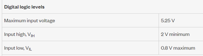

If you spend some time exploring Digital I/O product page, you should be able to notice which module has BNC connectors.
Among them, NI-9402 has BNC connectors and supports LVTTL. LVTTL is compatible with TTL for input. According to NI-9402 Specifications
