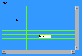

I have table that have transparent background. Assume some cells of it have text. Now when you remove text in cell, you continue to see this text in background, only when you click in another cell you will see that text was removed.
Somebody know how to prevent this bug?

I think this is a very special case that revelas how the table is implemented.
When you are editing a cell it appears a text box is placed over the cell and the user interacts with it.
On the plus side, if you do not click out of the cell after deleting its contents but click escape, your edit is aborted and the original text is un-touched.
When you delete some or all of the test in the text box, it back ground color is white and is sized to fit the string instead of the cell size. This part is consistatn with how string entries look and is usefull in spotting non-printable characters but...
In this specail case, the transparency lets you see the original un-modified text in the table behind.
At first thought you would think that the tables contents should update as the user updates the cell but ...
that would give us very bad performance if there was a lot of data in the table!
So the "fix" would be to make the text box background always be white and to NOT re-size with its contents.
Since this case is SO specail, I would not expect this to be changed very soon.

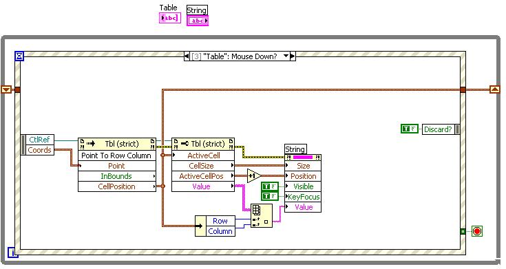

Attached you will find a LV 8.2 demo that gets you started with a work around. If you chosse to go thise route there will quite a bit of work to replicate all of the functionality found in the table.

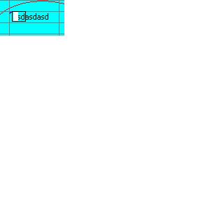

This is what it looks like after you deleted the text but BEFORE you have clicked out of the cell.
Ben
Not in 7.1 - when you click inside a cell, it is filled with white. Looks like someone decided to be clever and missed a corner case.
Edit - this is what it actually looks like. It appears that the code capture tool removes focus from all the selected objects.
