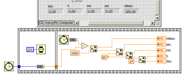

tst,
I pressed the accept as a solution too soon....Your idea of substracting two timestamps results in wrong elapsed time because of GMT zone (see image). I'm in GMT+1 time zone so that only works for GMT zone. I then tried to convert (typecast) the time stamp to DBL and substract it and it does not work either.
The problem is in the definition (or interpretation) of time stamp. It is time zone independent! I see that as a big problem since we are all in different time zones. To ilustrate, lets say I'm in GMT+0 time zone and I use time stamp for say elapsed time in my software and I see no problem when I test the sw. If I sell my software in GMT+X time zone, the elapsed time would always be off by X. To ilustrate my point further consider image below. I call Get date/time to get time stamp and I do same thing 200ms later. Indicators of time1 and time2 are correct and if one would substract the time values the result is exactly 200ms. But If I use substract function (the operation is legit since this is the elapsed time in seconds form 1.1.1904) I get wrong value because of GMT+X.
Anyway, I solved the elapsed time problem using tick count as a point of origin like this:
Best regards
Message 9 of 12
(9,415 Views)
The calculation is correct. The problem is that you convert the time difference back into a timestamp. A timestamp is considered always an absolute time and displays by default the local time. So your difference of 200ms is translated back into Jan 1, 1904, 0:0:0.200 GMT and then for display, it's corrected to local timezone. But just because you suppress or ignore the display of the date component doesn't make the timestamp magically a relative time. Absolute time is very much like a unit in many aspects. If you take a number that is kg and interpret it as seconds you get also rubbish.
The Number to Timestamp conversion has its uses, but can't be blindly applied to whatever values you have. It has to be a number that represents seconds since Jan 1, 1904, 0:0:0 or you get rubbish. A time difference or relative time is not seconds since this specific date and time, but seconds since whatever your reference system of your time difference calculation is, in your example this is the current time 2.
Just display the floating point value of the time difference directly and you will see a number of 0.2 which is correct. (well on your system you will apparently see 0,2 Smiley Very Happy)
