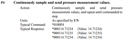

OK, I looked at your previous posts and found one where you posted the manual for this device, and it has this in it:
So it looks like what you're doing is putting in into "continuous" mode, meaning that if you sent the VISA write just once and then ran the VISA read over and over, you'd keep getting readings because it's set to send them forever.
This is likely causing your problem, because either when you write to file it's getting behind, or one of your two devices is set to a different sample send speed than the other is.  So you're never reading the most recent value.
You could try switching to this command instead:
That would probably make it act like you actually want it to.
If that doesn't give measurements fast enough and you want to use continuous mode, then you're going to have to make 3 loops, one for each device and one for file logging, to be sure that each device isn't holding the other back and that the file writing is fast enough and doesn't hold back the device reads.
