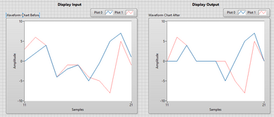

I am making a sub VI to threshold samples of data in form of 2D array and sum only out of threshold values
Here is mine but I think it was too much of a turnaround so can someone help me to simplify this 
  1. Yes, your code is way too complicated and probably could fit on a postage stamp.
  2. First you need to explain exactly what "threshold sample of data" actually means.
  3. Does your current code work correctly?
  4. You have an range detector, but upper and lower limit are zero by default. What are the correct limits? (please make reasonable values default before attaching!)
  5. Do you want to threshold each column separately or is there some relation between the columns that need to be considered?
  6. Taking a sum of zeroes will really never produce any interesting result, right? So why even do it?
  7. I think you need graphs, not charts. Do you know the difference?

Maybe something like this?

It's actually my friend's project, taking a meauserement from a brain tracking device OpenBCI, he said it's used for something like machine learning so only taking higher or lower signal and summing it then recognizing it as an order to send to another controller and then going to motor or something like that.

Thank you so much for helping me even I wasn't replying Immediately, there is another thing to edit.
It shouldn't be just a simple sum, it is summing from positive numbers or negative numbers, inside threshold(zero), positive numbers or negative numbers, inside threshold(zero),... and it goes on and on.
I am trying on doing that, but I got confused since the number of array component would be unmeasurable and the program should be able to count the size and sum numbers accordingly
But your answer is satisfactory, so I think it should close this thread, once again thanks
Your descriptions is not clear at all. How is the output supposed to look like (e.g. given the current default data).
Do you want to just count the number of items in each range? That would be even simpler. 😄

I'm sorry I was too tired to re-check my last VI post. 😅
Thanks to you I got better understanding of using these arrays and yes graphs is more relevant in this case. 😁
But since you're here, can you help me solve this again, I tried to make it clearer of what I was going to reach by setting default values into desired indicator.
I made some changes to your VI to better describe what I am trying to reach.
This is what I am trying to, I appreciate it if you could help, even just giving references, examples or answer from another forum discussion.
