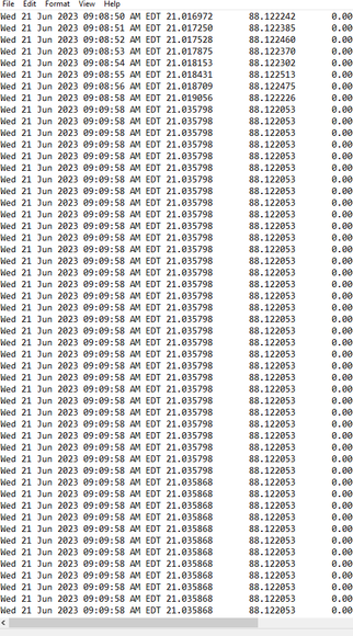

Thank you for the reply! I should have added more information, this is running on a cRIO 9045, so it has nothing to do with Windows. I no longer think that there's an issue with the file size - in fact I think that I have discovered the issue.
I have seen behavior before where there's a stretch of time on the XY plot that doesn't have data being written to it once per second. See below at 9:09 am.
I copied the XY plot data to my clipboard and moved that to Excel, and there were missing data points around 9:09. Then I went into the text file and checked around 9:09 am, and sure enough there were about 60 data points all at 9:09:58 am. This suggested to me that the queued-up Acquire states all unloaded in the span of a second (see following picture).
I thought it was odd that the XY plot writing loop and the consumer loops both got stalled, but the other loops in the program were working fine (queue size kept increasing which meant the save timer was working, front panel wasn't stuck on any particular tab, and indicators were updating normally), so I looked at the XY plot writing loop and the Acquire state of the consumer loops to see what they both shared in common.

Back to say that even converting all my subVIs that are called multiple times did not fix the issue. I had the same thing occur where the queue got clogged up with a minute's worth of Acquire state messages.
The weird thing is that it's been exactly a minute's worth both times that I've caught it.

I'll add that the files had only been created 30 minutes before the problem came up this most recent time, so I think it's safe to say file size is not at fault.
