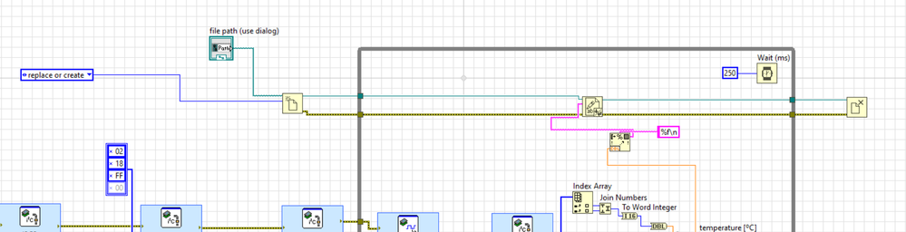

Temperature sensor data to text file
Accepted by topic author Aladdin2020
@Aladdin2020 wrote:
Well, that Open/Create/Replace File function is totally mis-wired.  There is no need to wire up the "prompt" input.  And that function does not need a double input for anything.  And your enum came from where?  Remove the Feedback Node and any wires connected to it, the enum, and the prompt input.  Right-click on the "operation" input and choose to create a constant.  I set it to Replace Or Create.  You also need to supply a path.

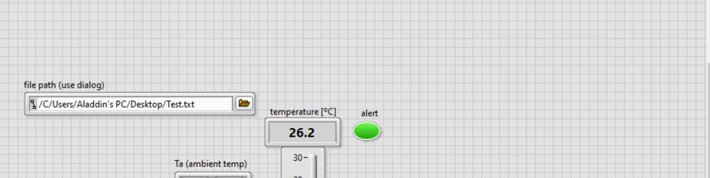

Thank you so much for explain the process here! This is crazy! I still don’t get any thing on text file! empty! the program would run but still won't write anything to text document!
not sure what is missing!
Message 12 of 13
(846 Views)
Your file path looks like a subdirectory that is on your PC, using the / folder format of a RIO.
Are you SURE you picked a folder that exists on the RIO?  In other words, does your device have a folder at the path /C/User/Aladdin's PC/Desktop?
(I kind of doubt it since it would be unlikely for a RIO device to have need for a desktop folder.)
If the folder doesn't exist, you may need to add code that will create any of the missing folders in the hierarchy.
