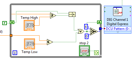

I am a student and relatively new to LabVIEW.  I am working on a project that controls the temperature of soil in a box full of worms. My goal is to have the temperature move freely between a range of 2 numbers, Tlow and Thigh. I have a temperature sensor that reads the temperature of the soil.  When the temperature of the soil, Tsoil, is below Tlow, I have the heater turn on using a DCU. When Tsoil is above Thigh, I have the heater turn off. The hard part is dealing with what happens when Tsoil is between Tlow and Thigh.  I need to find a way to make the heater stay on up until Tsoil=Thigh and then have it turned off until Tsoil goes under Tlow again.  Basically I need to use relaxation in place of a cooling mechanism becasue I dont have one. Any help is apprecated! Thank You!

Hi GerdW,
So I was able to follow the example you sent and apply that to my program. This is what I have. What is happening is when T<T_low the heater is ON but for T>T_low the heater is always OFF. I have never used a shift register and I am now in the process of teaching myself about. I was wondering if something stood out in this picture that looks wrong for what I want to do?
Thanks for the help, I really appreciate it.
(4,663 Views)
Accepted by topic author adeperro
Hi adeperro,
compare your CompoundArithmetic node with mine - and you will spot a (small) difference.
Small difference, big issue… 😄
Why don't you put this ExpressVI into the loop? Don't you want to control the heater all the time? (THINK DATAFLOW!)
Btw. cleaning up a block diagram before posting is highly appreciated!
Why don't you take those FREE ONLINE resources offered by NI for LabVIEW beginners?
