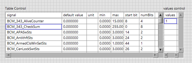

There is two tables on front panel. When scroll down the left table, right should be scrolled down automatically.
I manage to create this with arrays, but with tables, i just can't find appropriate property node.
Can someone advise please...

You are after a property node called index values

When index values are used, i'm not able to enter values in 'values control' table.
I can scroll them together, but functionality is then lost.
I tried both way.
Any suggestions?

My guess is that you are trapping a mouse down event to handle scrolling, and that something about your code structure is preventing data entry.  Post your VI and I'll take a look.
