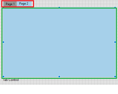

Tab control
I want to know how to change the color of the tab title ( red box ) without changing the tab page color (green box).
Thank you.

I don't think you can do that easily

You can’t.  But you can put a big rectangular decoration on each page and color them any way you want.
Or you can make the background of the tab ctrl transparent, and put a decoration behind it.

AFAIK there was a way to put an image into the tab selector...
(3,026 Views)
Hi Emna,
yes there is an option to show images in the tab selector: remove the text and include your images. Now you can color the tab selector a required (and different than the tab itself)…
