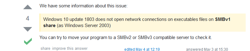

Hello bateme01, I have similar problems since a few days with labview, mysql connector and windows 10. Details are in my post ( https://forums.ni.com/t5/LabVIEW/MySQL-connector-suddenly-giving-error-2147467259-on-windows-10/td-p... )
But you nailed it!
If I run the .exe on my samba file server as I am used to do (only one place to update code) I get this error, when I move the code locally it works!
If anyone finds more info on this + workarounds I would appreciate, quite irrirating!

Accepted by rolfk
I found this more direct answer to the question about running exe files on smb v1 share.Smiley Sad
https://stackoverflow.com/questions/50155482/after-windows-10-update-1803-my-program-cant-open-a-soc...

The problem, as shown by Ola_A, is that the latest Windows 10 version does not allow a process to use Winsock, if it was started from an SMB v1 share. Solution is to either install the executable locally and run it from there, or to reconfigure the server computer hosting the share to use SMB v2 instead.
