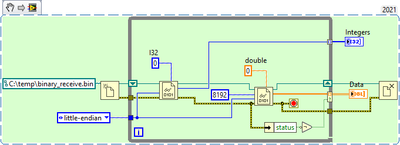

To familiarized myself with reading binary files, and I'm now writing a simple VI. I don't know what I'm doing wrong, but at the end, I get random values. However, I should be getting values between 0 and 1 for the first three values, and a value that represent the time passing for the fourth one.
My binary file is a 1D array of floats structured like this:
[Value1 Value2 Value3 time Value1 Value2 Value3 time Value1 Value2 Value3 time ...]
I’ve attached my VI and the binary file I’m working on.
Message 17 of 18
(694 Views)
Accepted by topic author Ouinon
The actual structure is the following:
- 1 4-byte integer  (= 256)
- 8192 8-byte double precision
- 1 4-byte integer (again = 256)
and so on. All binary numbers are little endian.
Paolo
Message 18 of 18
