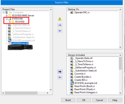

I am having difficulties to build an executable for running in cRIO, and to solve that took a step back and trying it as EXE for Windows but same issue.
The problem is now I am trying to build the NI example (copied from original directory) and the application cannot run because of the below reported errors.
- I added the dependency dll i.e. nii61850lvapi.dll also manually to the includes and see there is a warning that there are multiple source, one of them will be used. This means that during build the LV knows what is that dependency (and where to find it)
- Since I have this LV Library so to make sure all is included.
- I also copied the nii61850lvapi.dll everywhere that executable and OS could be looking into by default:
  • The same folder as the EXE
  • C:\Program Files (x86)\National Instruments\Shared\
  • C:\Windows\System32\
  • C:\Windows\SysWOW64\
Missing external function nii61850lvapi.dll:nii61850lvapi_Createled:C in VI 61850.Ivlib:Create IED.vi.

Hello Rolf and thanks for your reply.
Yes surely I have that and I am running the server and client VIs from LV successfully. In fact I am using the NI example which comes only with installation of the driver. Since I couldn't find the root of problem I tried this official example.
So the whole problem is that when the executable is built, it cannot find the dll.
I may try this on RT target, hopefully is less complicated.

Yes, I am running on the same computer! Actually I made installer and installed it (still on same computer) and that didn't help either.
For real time of course I have it installed already:
The problem might be a configuration, but I have tried different ways of including: even manually adding the dependencies to the project itself. So far no hope.
