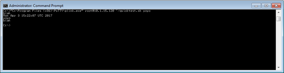

The purpose of the working directory still isn't clear to me.
I can launch a basic Windows app like notepad or calc and System Exec is blocking as @Yamaeda describes. Perhaps it has to do with the program I'm executing. Here is a sample program run from the command window:
I'm connecting to a remote client with putty. It prints "blah", then the date, prints back an argument (in this case "yoyo" is the argument), and finally it waits 10 seconds before printing "blah" again and returning. This works fine from the command window, but I can't get it to work from LabView with SysExec.
