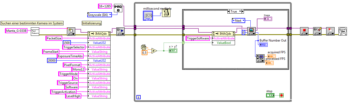

Hi all,
I am trying to get my camera (via IMAQdx) and a light source (serial) synchronized so that the light is turned on only during user-commanded acquisition in order to minimize photodamage. I assume that using a software trigger for both camera and device will do the trick. I both want to be able to take a single image as well as a sequence of images with a defined delay, which is why I decided to use an IMAQ Grab to save configuring time.
However, I am completely unable to program a simple working example of using a software trigger to control camera acquisition. I had assumed that, as in NI Max, it would suffice to set the camera attribute "TriggerSoftware" to 1 (see vi) - but the camera grabs images also when it is set to zero.
Can anybody give me a really simple working example of user-triggered camera acquisition?

I find the documentation on the Triggered Grab example lacking in information what's actually going on. However, I found a solution on another site:
http://www.labviewforum.de/Thread-Software-Trigger-fuer-AVT-Kamera
and for non-germanophones, the important thing is the use of the Get Image.vi instead of Grab:
http://www.labviewforum.de/attachment.php?aid=39411

Grab is High level function which includes Get Image VI if you had checked inside Grab.VI
-Ideally it's good to start with High level functions and depending on your requirements you can get use Low level VI for better configurarbility in acquisition.
-You can check low level functions example in Help->Find Examples-> Search Low-Level.
