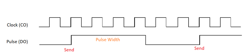

Best choices for #8 depend on what happens *outside of* the part of the timing diagram you've sketched.   Does something trigger the t=0 point?  What happens after the 100 msec pulse width?   Will you repeat the 2 pulse pattern sometime in the future?  When?  Is is based on a defined delay, a hardware trigger, or a software decision?
Currently, nothing triggers the t=0 point. After the 100 msec pusle width, the signals are just turned off. These pulses will not be repeated in the future. I want to trigger these pulses by a software decision, such as a start button or something.
I would be really thankfull if you could provide an example of the steps 5~7 you have recommended.
Thank you once more for your kind and detailed reply.

Here is an example I modified from NI-DAQmx: Correlated Digital I/O with NI CompactDAQ and LabVIEW. The CO will keep providing the sample clocks to the DO task. The DO task will output a pulse of specified width when you press the Send button.
I used simulated devices as I don't have access to the real hardware. Don't forget to configure your RTSI.

I kudo'ed ZYOng's example and am adding one of my own.  While there are a few similarities, our approaches are mostly pretty different.  See what you can learn by trying and studying both, then come back if you have questions about specific details.

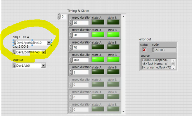

I'm actually trying to add more channels from the two daq devices: daq 1, daq 2. But it seems like when trying to add more channels from the same daq device, an error occurs.
what should I do? Can more channels be added using this type of code?
Thanks again for your effort. It's really helping me
Message 17 of 18
(1,464 Views)
A port is a collection of digital lines and it works as a single entity. Use browse or syntax to select multiple lines from the same port in a single task.
https://tmesystems.net/
Message 18 of 18
