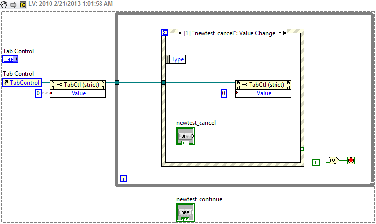

I'm trying to create the interface of my program using a tab switcher, and then using buttons to navigate programmatically. However... the buttons do not seem to switch the tabs. Occasionally one will work, but 99% of the time it fails. I have attached a simplified version to demonstrate this problem.
I suspect this is a bug -- running the program with highlight exection works perfectly.
Thanks for your help.

I am not sure if this really expected behavior what you are seeing.
But you have to certainly clean up your code.
I made some tests and the recommended way to solve is the following:
1.) Put the terminals of the buttons in "their" event case
2.) Change the event from "mouse up" to "value change". It should work then.
Norbert
EDIT: The more i think about this i can explain the behavior by the following guess: mouse up does not initiate a re-draw event for the UI, so the tab control simple doesn't get redrawn with the new active tab.
Norbert

I see the same thing with highlight vs non. However, I have not seen many uses of buttons and event structures that are not latch-when-released, and value-change:

I have seen similar things in the past, where a tab control does not switch when using a local variable. Using a value property node instead solved the issue, probably for the reason Norbert suggested - it forces a redraw.
That said, I agree with the others that I wouldn't do it like this.

Thanks -- using a property value works. You said you wouldn't do it like this -- is there an alternative you would do? I'm trying to make the interface for this program event driven, and this seemed like the simplest way.
(4,420 Views)
There's nothing necessarily wrong with using a tab control and controlling which page is displayed programmatically. I was refering more to the style (value change, terminals inside event cases, not having race conditions, etc.).
There are also other alternatives like having each step in a separate VI and displaying it in a subpanel, but that can be more complicated.
