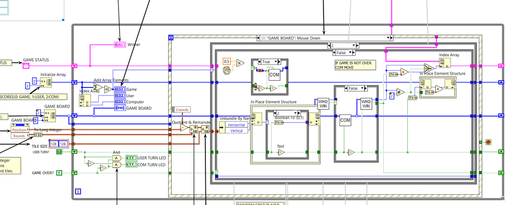

I attempted to introduce a random player for the second round by adding a new state. However, the current setup always starts with the user as 'X' on a mouse click. I tried reordering the computer's moves and adjusting the conditions within the case structure, but something went off. The game's behavior is now erratic and doesn't function as expected....😥

After the game ends and when I press the start button, I tried to let the computer randomly make the first move before transitioning to a new board for the next game. But it doesn't seem to fit the structure.
I attempted to have the computer make its move before the player during the mouse down event when the game status is at 2. However, this results in the computer moving twice in one turn.
It seems impossible when both the computer and the user are within the same event. To make it work, I might need to completely separate the user and computer turns within the event case. It's challenging.
Message 18 of 20
(1,309 Views)
When the score is 2 or higher, I tried to detect the start button through the event structure to have the computer make a move at the beginning of the board setup. However, if no event occurs, the process doesn't proceed, so this approach also doesn't work.

Hi zubat,
Did you read the LabVIEW help for event structures?
(Strong) recommendations
  • Use only one event structure per VI!
  • Don't hide event structures inside case structures. The one event structure in your VI should live in a loop being able to iterate all the time…
  • Why don't you place the code of that upper-left case structure in the event shown in that bigger event structure???
Other items:
  • Use less/no locals. Why is "Game" a local when you can branch the wire to the Game indicator??? And why do you need a DBL indicator to display an I32 value?
  • Straighten your wires! Why are all wires into the big event structure bended?
  • What about strict left-to-right wiring? That case structure in the upper left clearly violates that recommendation several times…
  • There is no "score" visible in your image. The case structure depends on value of "Game"…
