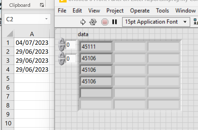

Hi everyone, I am trying to get data from an Excel sheet to LabVIEW but I get the value of Timestamp as number, 45111.
I usually faced this when I open a CSV-File in Excel.
I tried to select/deselect 'Use 1904 date system in Excel' but nothing happened
Maybe someone can help?
Attached is a screenshot of my code and Excel sheet
Thank you
Sinan Ismael.

See Formatting LabVIEW Date and Time Data for Microsoft Excel

Check this post, how to convert Excel date into LabVIEW date formats.
They use different date systems.
LabVIEW to Excel (there is some explanation) https://forums.ni.com/t5/Example-Code/Convert-Excel-Time-to-LabVIEW-Time/ta-p/3996348
Excel to LabVIEW - https://forums.ni.com/t5/Example-Code/Convert-Excel-Time-to-LabVIEW-Time/ta-p/3996348

Ok thank you.
I hv to read the timestamp as float.
