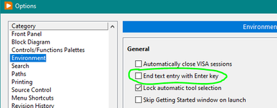

There are two "enter keys" on your keyboard.
They behave differently depending on your LV options.
(5,039 Views)
If that option is checked, you can use Ctrl+Enter to apply an EOL.
