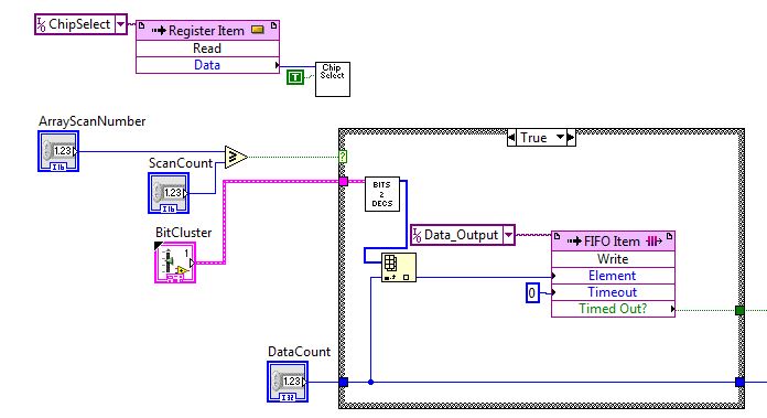

It looks to me like a good method to debug the code.
I went throught the VIs and unfortunately without knowing the specifics of the hardware I am not sure I will be able to say much. There is one thing I noticed, but I don't know how significant it is in your case:
In this configuration, the ChipSelect.vi can execute before or after the main part of the code (we can't be sure). This can potentially cause some problems.
(4,773 Views)
Thanks for the tip Stockson, I'll try to make things a bit more deterministic. We found out that my original simplified version of the code (AFE0064_Driver_v5p22p1.vi), which just reads a single module, generates a great image. I've hacked a loop around that code since the chip select is user selectable and just stiched the images together on the real-time processor side. It's slow, but it gets the job done well enough for further hardware debugging of a full 12 module system.
I'm reviewing my code now, and little details like what you pointed out probably add up as things grow in complexity. Thanks.
