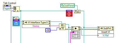

Hi volks,
i have a main vi with a tab. Each tab should contain the same vi but they have to run independendly from each other. Therefore i placed subpanels within the tabs. I load the sub panel vi (preallocated clone) by using "Open vi reference" with parameter 0x80 (what should not be needed), call "Start asynchronous call" (as I don't want to to lock my main vi) and give that reference to the "Insert VI" method of the sub panel.
This works fine.
However I need to keep the reference to the reentrant clone and pass it over to other vis. And that's where my problems start - I won't get it right.
I tried the generic vi reference constant in my cluster to store the reference but here I cannot bundle the reference, that came from "open vi reference" as the generic type constant does not accept the strict type, that "open vi reference" requires. I tried to make a strict type reference constant and placed it in my cluster. But it is not working, too. Here it claims a "wire: function conflict".
I tried generic reference with "to more specific class" but the polymorphic vi doesn't accept strict typed vi references.
So to sum it up:
- Generic vi reference and no dynamic vi instance = ok
- Strict typed vi reference and store this ref in a cluster = bad
Is there a solution for this problem? Or is there another way I can achieve the same goal?
What I want:
Main VI with multiple tabs, all tabs contain a sub panel of the same vi. Those vi instances have to run completely independend. There must be no effect to each other. Those VIs have to run independend from the host vi. The sub panel vis have own code with UI and interaction, the host decides when and how to close them (right now I implemented a notifier to do so).
Have a nice weekend 🙂
Create your constant from the refnum wire that comes out of your "Open VI Reference", so you will be sure to have the correct strict VI refnum type.
Also, showing/attaching some actual code is often more efficient than trying to describe your problem textually.

If anyone stumbles over this thread, here's my solution.
Message 9 of 9
