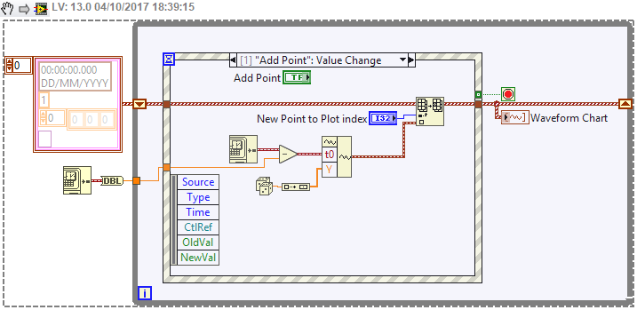

I can see from the nugget and some of the replies that I can create something like this:
which allows me to add points to a given plot as they arrive, but it seems like this makes my number of plots a fixed, edit-time decision.
Although this was only a very quickly written VI, is there some better way to plot into an existing plot or 'Channel', when new data for other channels is not available?
Edit: I can probably store an array of waveforms in a shift register, not holding any data, and just branch data then use Replace Array Subset to add any new points I have. If I want to change the number of plots, I change what's wired to the right SR.
Something like:
This resets the Chart when a new Channel/Plot is added, but that's probably not a big issue.

Actually, that snippet has some odd issues due to storing the most recent point per plot when resetting on new plot addition.
If I had followed my own description when writing it, it probably would have worked more sensibly.
